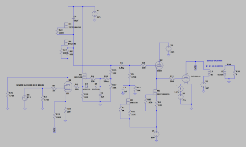

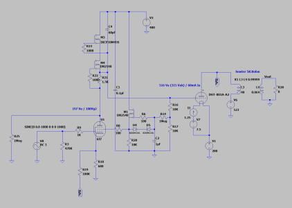

Wanted to show you something pretty cool and also ask if you have any input on something else. I have been hanging around diyAudio and discussing ideas for these high-gain CCS fed pentodes. A certain someone who maintains a certain DIY tube blog suggested a fancier g2 supply for my pentode driver rather than the 1Meg resistor from B+ I was using before. The idea is to use a local feedback mechanism with the DC voltage fed to g2 via FET, with the voltage derived from a divider from the mu output of the CCS. Seems similar ideas are floating around a few places, but the one that inspired the suggestion to me was done by JC Morrison on his transconductance gain block here:
http://www.labjc.com/?p=5317
In this arrangement, any drift in the plate voltage is communicated down to the screen, I put together some Spice models, built out the circuit on a protoboard and gave it a shot, schematic below.
What I found is this setup provides VERY stable anode / screen voltages. At maximum output into a 8ohm dummy load, sine waves as well as real music, I never see a voltage drift more than 0.5V on either, pretty nice, so this is going in the final design. With the exact setup I have shown below, I am getting 0.14% THD at 1W out of the amplifier.

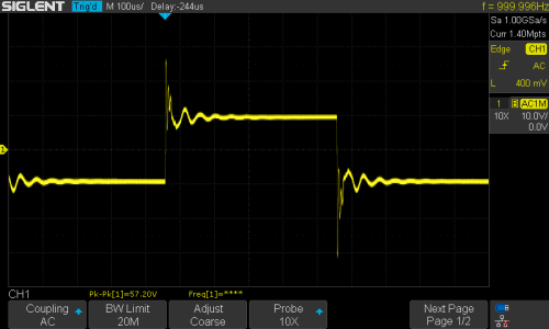

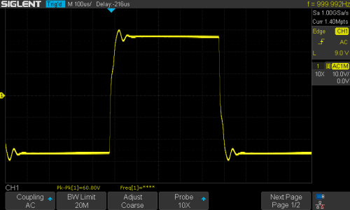

This design is 95% of the way there, just a matter of dialing in the feedback / output impedance / FR / harmonic profile when the Sowter stuff gets here. The only niggling thing left is some somewhat ugly overshoot / ringing I am seeing on square waves, shown below as well, the output from the EF37A. The amplifier is stable, perhaps it is a non-issue or will resolve with the Sowter OPT, still need to do some more troubleshooting, but the Lundahls seem quite prone to this type of ringing, we will see.
