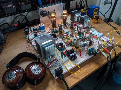

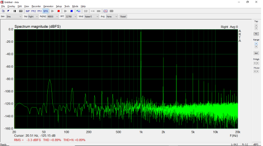

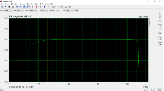

I finished the second channel, the heater regulator I was also using as a bias supply was injectin HF noise into the EF37A grid, so I had to make a switch, nice and quiet now.  Maybe it was the tube swap, but the feedback and measurements improved in the final circuit, but HF extension, lower distortion and output impedance.
Output Z: 1.53ohm
Power: 6.2W into 8ohm
I had a listen with headphones, then lugged it into my stereo, the sound is very nice, will do some more tinkering of course but it won't be long before it is boxed.

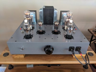

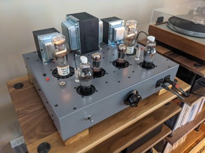

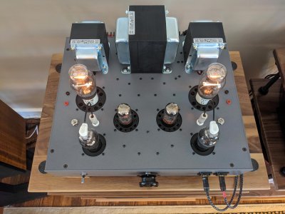

I finished my 801A amp PB, here are some pics.

Really good, best of the amplifiers I have made so far, the real standout is the bass, unlocks a new level of potential from my Snells!  Great clarity and detail too, the speakers disappear.
Thanks for your $0.02 along the way.  First got the idea for an 801A build over a year ago now, figuring out how to make it happen was a serious learning experience.
