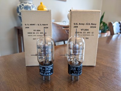

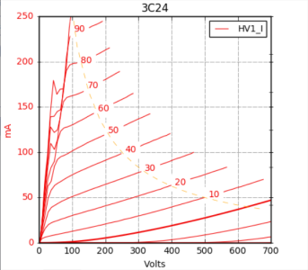

I got my functioning 3C24 PB.  Traced the curves too, all looks well.  Plate resistance around the bias point I am thinking is around 9.4K.

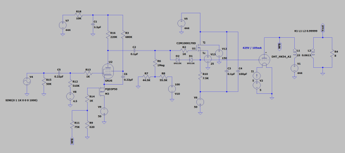

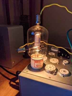

Here is my latest A2 transmitter craziness PB.  A few months back when I was thinking about the 3C24, I picked up a pair of HK54.  Price was $65 for a NIB pair, good deal in retrospect, was just curious but didn't know if I'd ever use them.  Well now more serious about the idea as I am learning more about this topology, might even try them out in place of the 3C24 if I can find more pairs.

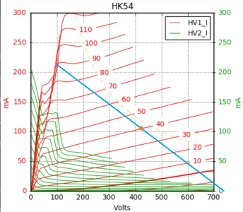

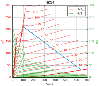

I traced A1+A2 and grid current curves on my tracer, came up with a 425V 105mA bias point using a 3K load, plate resistance is about 9K.  I put together an LTSpice DHT model using Dmitry Nizh's modeling tool and made a simulation.  Using 6AU6 on the input, get an open loop gain of around 220 from the stage.  Given that the HK54 will draw a whopping 50-60mA of grid current at peak swing, thought a cathode follower was probably impractical (bias + grid current would make for a monster power supply), so a FET buffer instead.  The gate would be biased positive using a voltage divider from the regulated B+, then a bias pot to dial in the HK54.  For the output transformer, I subbed in the Lundahl LL1623 120mA model, 23H 164DCR primary, rated for 25W at 30Hz.
With this setup, I can apply about 22dB of feedback and get a damping factor of about 3.5:1, could improve that by changing the pentode to something like the 6EW6.  This makes for close to a 15W amplifier, not bad for a 450V B+.

60mA isn't impractical for a cathode follower.  Try high gm tubes like the 6BX7, 6BL7, 6080, 6AS7, 5998, 12GN7, etc.  With your 40V of bias, what's the standing grid current?
What I really like about what you've cooked up there is there's very little swing above the 0V grid voltage line, so that could make for a far simpler design overall without sacrificing much.

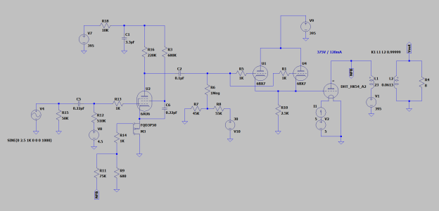

I thought the exact same thing on the negative grid swing, sacrifice a little power for a more simple power supply.  I mocked it up both ways with that in mind.  With the negative grid boundary being 0V, I rebiased to 375V 120mA.  This brings the quiescent grid voltage to around 48V.
At idle, the grid will draw about 8mA.  When I was mocking it with a cathode follower, I was looking at using the 6AH4, but might be better to go with 6BX7 or 6BL7 and parallel the sections, like I am doing in my 801A amplifier, which draws far less grid current.  At one point I had thought to use the EC360, similar to a 6AS7G but single triode, but with the bias current + peak grid current, the B+ supply would be drawing something like 500mA.  Going with a 6AH4 / 6BX7 / 6BL7, etc., the current draw would be much more manageable.  As it so happens, I have quite a few 6BX7 and 6BL7 handy.
Put together a schematic below, still makes for a 10.5W amplifier without a negative supply and avoiding the A1/A2 transition point, the curves get much more cramped beyond. Would either need to run the B+ supply through a voltage divider or make a separate low voltage supply to bias up the CF grid.  With each section of the 6BX7 biased at 10mA, idle current draw on the B+ supply would be around 300mA, then around 400mA at peak grid swing.
Another advantage of this approach - voltage swing around the 375V bias point is more linear, should make for a good first watt.

I have a pretty strong proclivity toward amps that look like that design.
You could split the 2.5K cathode load into a Hammond 154E and a resistor in series as an experiment.
Ahh yes, something to try in breadboard, will keep that in mind.  Could potentially get the full negative swing after all, so long as it doesn't anger the feedback gods.
Well I'm excited about this, altogether not an overly complex design without the negative supply.  Need to decide if I want to change to a higher gain pentode for more than 22dB of feedback for a better damping ratio.  Might try different amounts of feedback and tune by ear.  The 3K 120mA 23H Lundahl is probably the best off-the-shelf transformer for the job, but will see if there are others out there.

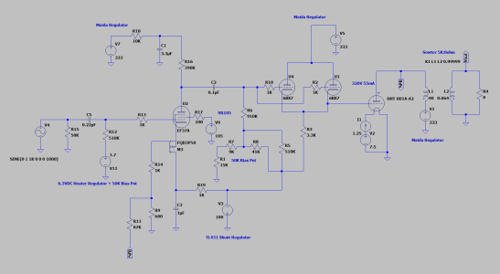

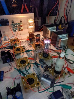

Hey PB - at long last, I have some preliminary results on my 801A A2 build.  Since the circuit was going to need a breadboard anyway, I decided to put together a reusable prototyping board, I combined the two projects into one.
I finished the board a few days ago and finished a single channel of the amplifier.  The plate-to-cathode feedback is buffered by a PMOS on the cathode of the EF37A.  I had some heater regulators from another project on hand, so I put DC on the EF37A heaters then ran one end through a bias pot to apply grid bias to the pentode and dial in the operating point.  I used a VR105 glow tube to regulate the EF37A screen.
In this first iteration, this comes out to around 11dB of feedback.  Output Z is 1.7ohm, which is great, hit one target on the first go around.  Clipping starts beyond 6.3W into 8ohms.

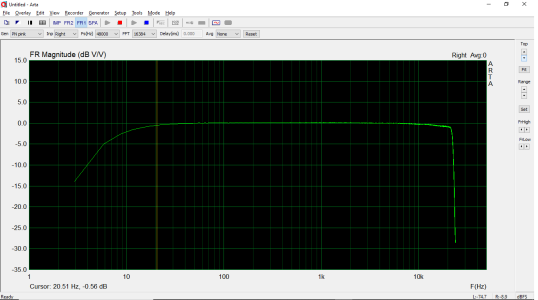

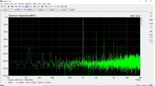

THD is a bit higher than expected, 1W into 8ohm spectrum below, which I attribute to the open-loop gain of the EF37A being much lower than simulated (I had thought I would be able to apply around 15dB of feedback), so that is what I will be investigating next. The harmonic spectrum is favorable, so even as is I feel confident the sound will be pleasing.  Ultra low distortion wasn't necessarily a very high priority, we'll see how it sounds once I finish the other channel.
Edit: I should note that going from 1W to 6W, the distortion *only* climbs to 2.5%.

Thanks, mcandmar, don't mind sharing the design, but I have to warn that it is a bit of a doozy, complicated, at least by my standards.  Both the output transformers and mains transformer are custom jobs, although you could probably make it work with off-the-shelf stuff, but likely more transformers needed, especially for the 801A filaments, I was able to get everything wound on a single core with internal shielding.  The 801A is a tricky tube to use given its high plate resistance, necessitating either a high impedance OPT or use of NFB, I went with the latter after getting subpar results with the former.  I've attached a pretty accurate amplifier schematic below.
