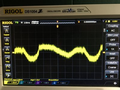

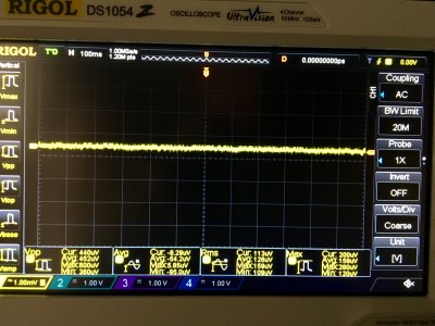

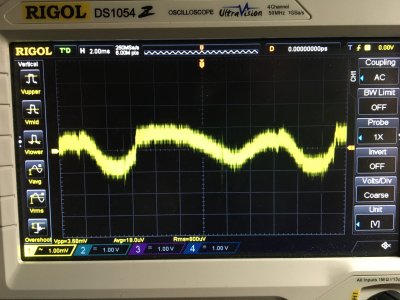

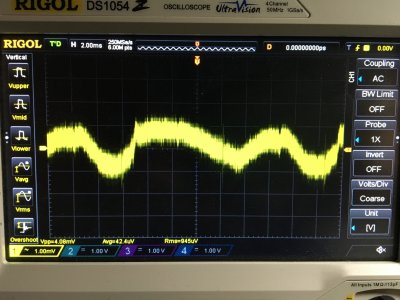

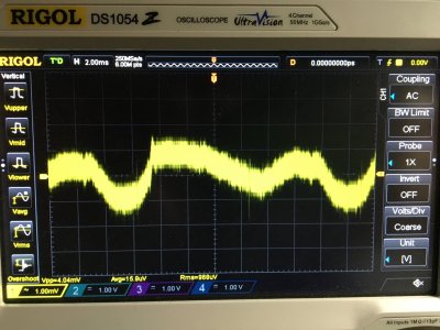

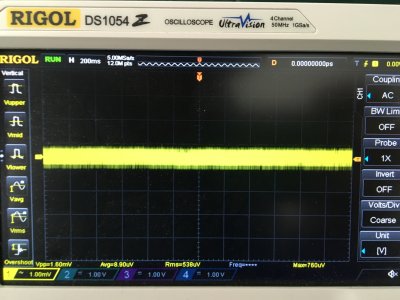

What points on the transformer would you like me to measure? What would be the ideal setup on the scope to take these measurements? How many V/Div would you like me to setup for? I'll take the measurements after work today.
@Grainger
The big reduction of the measurement came from a ground that I missed. Even though the measurement was reduced, it seems that the hum was barely reduced if any. I have my soldering iron (that wasn't powered on), and my oscope, both plugged into a rotel rlc900 line conditioner. I can unplug everything and go straight to the wall if need be. When I first experienced the hum, I tried multiple outlets in my house, in two different line conditioners, I've also tried plugging into an isolation transformer, the hum was present no matter what.
@Grainger
