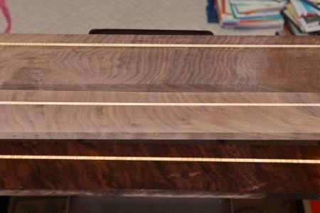

Here is the wood that will be used for the chassis frame.  It's some nice cross-grain figured walnut that I found at the local flea market.  I split it and added a 1/4" stripe of tiger-striped maple.  There are three boards in the image.  From top to bottom are the rough glue-up, the middle one has the layers sanded smooth, and the third one is after applying a coat of pure Tung Oil, allowing it to soak in a for a few days, then top-coating it with some Formby's Tung Oil Finish (which I'm not sure if it actually contains Tung Oil or not).  I tend to like darker wood.  Still undecided, though, about that top plate  :-\

Wow. That is some beautiful wood. Nice inlay work. My vote would be for black powdercoat and black anodized screws/bolts.  But you might also try brass screws/bolts - they might actually look nice with a black chassis and the brass end bells.  Or go with black everywhere except brass on the on-top OTs or chokes (I don't remember which is going on top in your build).
That amp is going to look (and presumably sound - since PJ designed it) great!
cheers, Derek
The only parts visible from the top will be the three PSU caps (black), the PGP8.1 (bell painted and lacquered to match brass), the TFA-2004 output transformer (actual brass bells), and the three tubes.  Of course, the usual fair of input/output jacks, power switch, fusing, etc. will also be on top.  Everything else will be hidden below deck.  I'm thinking I will need to cut some slots for airflow around those big power resistors - they will be mounted directly to the underside of the top plate with a little thermal paste for good heat transfer.

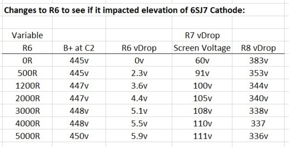

OK - now I'm totally confused.  I installed a 5k pot in place of the 1k2 resistor at R6 and made some voltage readings across the pot as I adjusted it.  As I adjusted the pot toward 0 ohms, the voltage across the pot (R6) fell.  At the same time, the screen voltage on Pin 6 between R8 and R7 also fell, to about 80v (was 100v with 1k2 resistor in R6).  I was expecting exactly the opposite..
Looking to achieve something closer to 60v across the pot (leaving the 170v target on the plate), I adjusted the pot toward 5k  and the voltage across it started climbing.  With the pot maxed out at 5k, the voltage across it increased to only 5.5vDC.  With a value of 5k in the R6 position, the driver screen voltage rose from its previous 100v to 110vDC.
I was sure using a pot would solve this problem, but it didn't.  Any ideas??

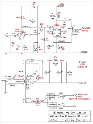

Here's what I think is happening with the screen voltage -
With the pot at 0 ohms, the tube turns on harder, drawing more current, which then pulls the B+ voltage lower. Since the screen node is a voltage divided version of B+, it also drops. With the pot at 5K ohms, the opposite happens. Can you confirm all this by monitoring B+ as you vary the pot?
Thanks for the suggestion, Raymond.  Attached is a chart of various resistances at R6 and resulting B+ and voltages at the divider for the driver screen voltage.  The asterisk at 1200R is the original value from the schematic.
I attached an old speaker and my iPad for the first time today and it makes music!  Woohoo!  It sounds good to me - only a single channel on an old speaker, but there is no obvious audio distortion or other distress that I could detect.  With the hum pot adjusted for 0.0mV AC at the speaker terminal, I can hear a faint hum from the woofer with my ear next to it.  The woofer was silent when I connected the 10,000uF cap across the heater.  The speaker output volume gets to about where I expected it would with ~8w of output from an underpowered input (max line level output on apple devices always seems low to me in the context of CD player/DAC output).  It sounds like the amp is functioning properly.  The only issue is that voltage measurement across R6.
Edit: the 6SJ7GT datasheet indicates a maximum plate voltage of 250v and a maximum screen voltage of 125v, so I don't think the amp or tubes are in danger with the 1200R in place for R6.  I've also attached a more complete voltage chart on the schematic.

Doesn't look like there's significant change in B+ voltage to account for the screen voltage change. It looks like R6 varies the amount of current into the screen grid though (the difference in current through R8 and R7). I wonder where that current ultimately flows to, as it doesn't seen to be going out of any of the other pins of the 6SJ7.

Looking at the schematic again and the associated voltage drops that appear between B+ and Ground in the driver circuit, adjusting R6 seems to have little impact on achieving the 170v target plate voltage.
Total noob question here:
Is there any immediate danger associated with me adjusting the 91k value of R9?  If I increased the resistance of R9 to something larger than 91k, would it drop more voltage, thereby decreasing the plate voltage and allow more voltage to develop across R6?
Does this sound reasonable, or am I missing something fundamental here...

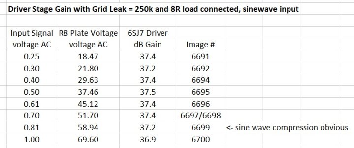

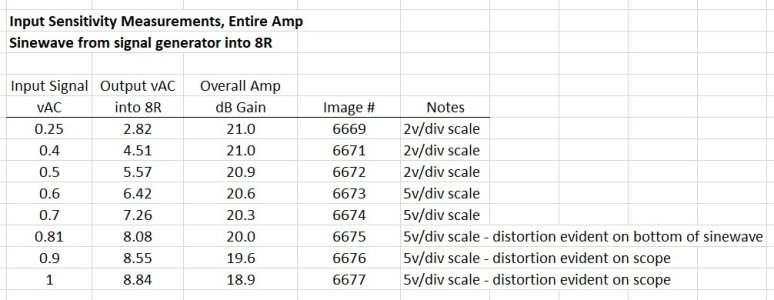

I spent some time making measurements with some meters, a signal generator, and scope with the hopes that someone can either guide me toward making a change to elevate the driver cathode/adjust the plate voltage to the intended voltage, or just leave it alone and start enjoying the amp.  Overall, the amp with the PSVane 300B tube can drive about 8v into an 8R load with an input signal of 0.8vAC before distortion becomes evident on the scope.
Here is a description of the tables I've attached:
The first attached chart is gain measurements of the 6SJ7GT driver stage, measured at the "input side" of the coupling cap with an 8R load attached.  Looks pretty constant at about 37dB of gain for the first stage.  Don't know if this is where it is supposed to be or not...
The second chart is the overall gain of the entire amplifier into an 8R load as well as input signal level sensitivity. Overall gain for the entire amp into an 8R load looks pretty constant at about 21dB.  This seems a little low to me, I was expecting somewhere closer to 27dB based on some comments PJ posted some time ago on another forum.  It also took close to 0.75vAC input in order for the amp to reach maximum clean output on the scope.  PJ's prior posting also indicated an input sensitivity of about 0.35vAC, so this figure looks a little "off" to me...

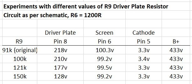

The third chart is an experiment with different values of the Driver Plate Resistor R9.  I didn't know how safe this experiment would be, so I only powered up the amp briefly enough for the B+ to stabilize and make a reading, then I shut it down.  Changing R9 seemed only to impact the plate voltage and didn't do much to the cathode elevation.

So, is there tweaking to do to adjust plate/cathode voltage levels?  A few of these readings seem to deviate from my expectations...

Looking at your 3rd table, it does look like the current into the screen grid flows out of the cathode. (Previously, I was just looking at the voltages marked in the schematic.) If you could raise this current, the cathode voltage should rise. In turn the driver tube should draw less plate current, which would drop the plate voltage. You could raise the screen current by lowering R8 or increasing R7.
Anyway, all of that is just conjecture on my part, so proceed cautiously.  ;D
If you're going to put a pot in for the cathode resistor, you will want to adjust it very, very slowly to get the target plate voltage.  You are looking to be very, very close to your original value.  If you're off by more than a couple hundred ohms in one direction or the either, you will fall off a cliff so to speak in terms of operation.
