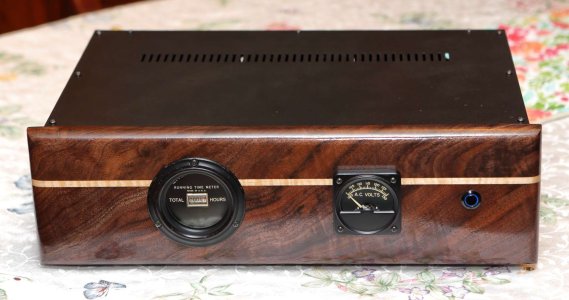

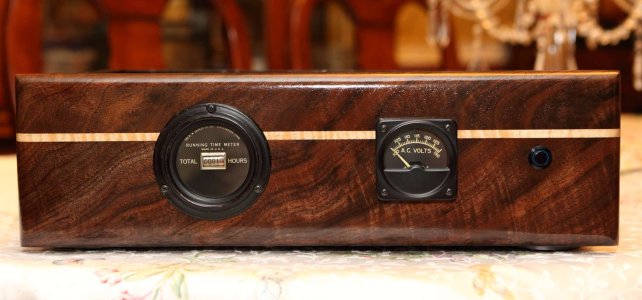

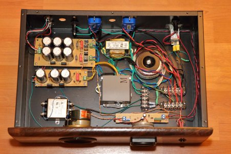

I ended up building a new box to power my analog rig: it has a single switch that controls two outlets on the back.  The first is standard household AC mains pass through, the second one uses the bucking transformer for a 115-1117vAC supply to the 300B mono amps.  This outlet has a separate 2A slow blow fuse to prevent overloading the Hammond filament transformer.  Inside the box are also my outboard power supplies for my turn table and my turn table preamp, both connected by an umbilical cord.
I made a nice front panel to match the amps and installed a vintage voltmeter and a vintage hours meter.  I liked it very much until I plugged it and found that the mechanical hours meter makes a bit more whirling noise than I want.  I'm thinking I'll look for a more modern replacement that will run more quietly.

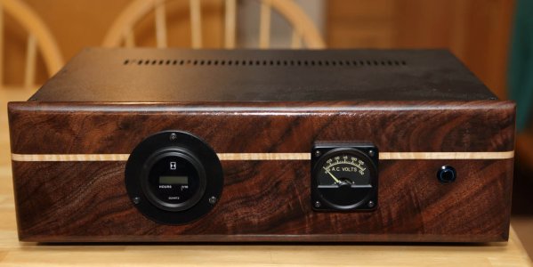

Someone suggested that I insert a resistor and see if that reduces the noise level. It did reduce the noise, just not enough to make me happy.  Any resistor greater than 10k results in the meter not moving at all - it just buzzed. Smaller resistors in the range of 1k to 7k actually allow the meter to move and certainly reduce the noise, but still not to a level that I find acceptable.
Bummer. I think I'll need to look into digital meters and find a way to mount one inside the housing for the mechanical meter since all of the digital ones have a smaller diameter face plate.
Thanks for the links, Tubejack.
OK, I feel like I cheated by replacing a period hour meter with a new digital one, but it is much more quiet than the original one that I chose.  I think it's time to call this one done and move onto other projects  :D

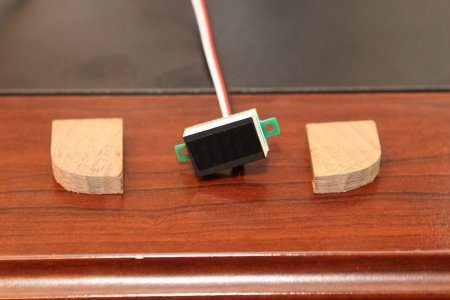

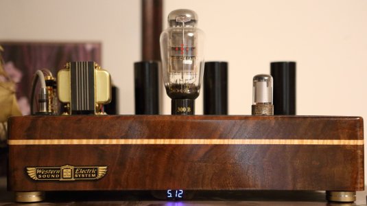

To keep an eye on the filament voltage, I picked up an LED voltmeter from Amazon.  I like this one because it has a calibration pot on the back:  https://www.amazon.com/bayite-Voltmeter-Motorcycle-Polarity-Protection/dp/B00YALV0NG/ref=cm_cr_arp_d_product_top?ie=UTF8
The display is a bit bright, so I put a strip of LED dimming tape across the display:  https://www.amazon.com/dp/B00CLVEQCO/
The tape tames the brightness and makes it much more subdued, but still easy to read.  Mounting the LED to the inside edge of the chassis bottom makes it practically invisible unless you squat down and view it from directly in front.  While I didn't do any output FFT measurements yet, I cannot hear any adverse effects such as hum or distortion as a result.  Now it's super simple to keep the filament voltage in the recommended 5.00v to 5.25v range.
