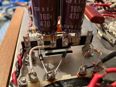

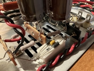

32 having 2V across it is concerning, can you post some photos of the power supply section of your Moreplay?
They’re all DC. Here are the photos:

I see several joints there that need a lot more heat and a little more solder. The lower joint next to the one with the red circle looks to have been missed, as does the one two over where the white wire from the transformer terminates.
