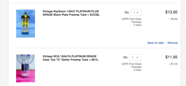

Hey, another new builder checking in. I have about 4 days of listening in on my new crack. I'm holding off to install the speedball so I can get used to things first.
But... I do want to try a few inexpensive tubes. I've read a bunch of this thread but not nearly all.
2 questions.
1. Does the Input tube up have a more noticeable effect on the sound?
2. How do these two guys look for an intro into rolling? (See attached screenshot)
**Edit, pretty sure I found the answer to my first question.
Paul Birkeland said:
The general rule of thumb (IMO) is that the more gain, the more influence.
Since the 6080 is wired for unity gain, the 12AU7 should have a vastly greater influence on the sound, though there are some special 6080 variants that may suggest otherwise.
