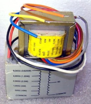

You mean, I think, the oldest ones from before the Specos. Your transformers are very similar to the Speco, and should work about equally well.
I believe Sam has the Specos as he has a 2.0 kit and I sold him the mq iron for his upgrade.
Sam, the old transformers have yellow tape around them, correct?  If so, the directions are found earlier back in this topic.
-- Jim

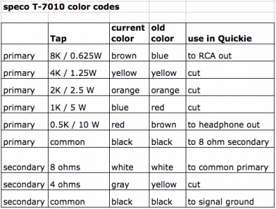

cvandyke said:
I have an older pair of the Speco T-7010 transformers which were removed from the original Paramours during an upgrade. These older transformers did not have the same color coding as the new production ones. For installing these in my Quickie, I developed the table below and thought this might be useful for other bottleheads with older Speco transformers.
--Chris
{Editted from original post which was badly worded}{Editted again to fix stupid error in table}

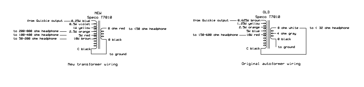

Paul Joppa said:
Here is a first draft of wiring for the two versions of the Speco T-7010 output transformer. This is for the stock setup (not optimized for choke or PJCCS loads). I'll update it when I have done some more measurements and analysis.

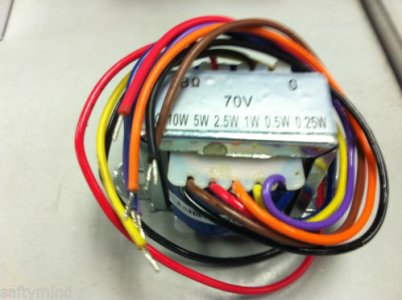

Re-posting missing images, added images of new and old versions.

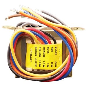

First of all, thanks to Bottlehead for a great piece of equipment.  It worked right out of the shop without any issues.  I want to convert it for headphone use.  I was confused by all the threads and would appreciate any input regarding the parts.  I have a Quickie 1.1 without the PJCCS (I have the add-on but haven't installed it yet).  Are the following parts the correct ones?
Neutrik NMJ6HC-S 1/4" Stereo Phone Jack Switched
Brand:
Neutrik
| Model: NMJ6HC-S
Speco 10W 70V Line Transformer
by Speco
http://www.amazon.com/Speco-10W-70V-Line-Transformer/dp/B001MJFB8E
Thanks in advance.
