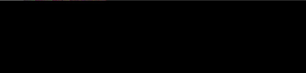

Here is a first draft of wiring for the two versions of the Speco T-7010 output transformer. This is for the stock setup (not optimized for choke or PJCCS loads). I'll update it when I have done some more measurements and analysis.

Thank you Paul for the diagram.  It made wiring it up much simpler.  Also, thanks kkinc to your suggestion.  They both worked pretty well, however, I think Paul's version has a tad more volume.
Paul:  Do you think there will be changes if the PJCCS module is installed?  I have one in my Quickie.

Stock or modified, I recommend experimenting with adjacent output taps.
You should always use the lowest-power primary tap for the transformer input. That tap will use the entire winding, and have the most inductance (more turns = more inductance). Unless you hate bass, inductance is your friend!

I rewired last night with good results. I originally had the 8 ohm connection wired like the old one with 8ohm tied to common and 0 tied to ground, Now it is exactly as Paul has it in his diagram. Does seem to have more volume. Also, maybe a bit more balanced sound. Tried all adjacent taps as suggested and tried both chokes and pjccs. Blue wires on output and brown wires on headphone jack produce the absolute best sound and most volume for my 60 ohm cans.
Very little difference between chokes and pjccs. Big difference with an amp and floor standing speakers, since the chokes hum. No hum with headphones.
