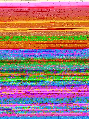

Here's a 404 on top of a SR. Exact same mounting hole positions although maybe stacked perpendicularly ?
"...Alas, 'tis just as I feared..."
The coil axis is aligned with that of the power transformer. The transformer must be rotated 90 degrees to avoid magnetic hum pickup, so the chassis width would probably need to be increased.

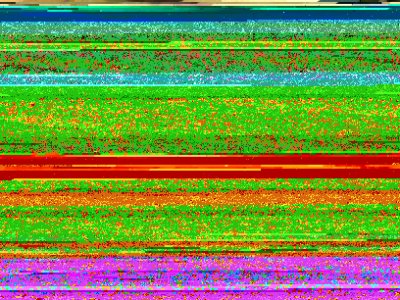

Here's a sketch of the chassis plate. There are two narrow vertical PC boards between the transformers (right) and tubes (left). The one nearest the vent is the heat sink farm; the other is the capacitor farm. So far I've only laid them out enough to place the mounting holes.
Nah - somewhere I read that there is actual science-type evidence that people like the Golden Ratio (it happens to be very close to 2/3 of an octave so I use that) - so I built this on a 10x16 plate.
