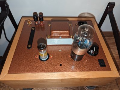

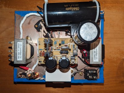

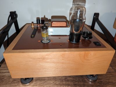

And they live.
Was able to get the 45 measurements right with the 180k resistors on the board and a 900ohm cathode resistor. But it was driving the 6cm7 into oscillation. Dropped in a pair of 160k resistors on the PC board and a 1.6k cathode resistor and everything is happy now. 248v 1.5A at the 45 plate, no oscillation in the 6cm7, making beautiful music. They do have a touch of audible hum but I think it is either a ground location issue or the long wire from the inputs picking it up. So still a bit of tinkering to do but they sound great (just have to turn the volume up a bit).

The culprit for the loud, asymmetrical hum was the ground wire from the PCB to the IEC ground. The noisier amp had that ground wire between the PT and C-7X. I cut it a touch too short when building that amp so routed it a bit different. Rerouting it to the outside of the chassis eliminated the loud hum.
But while poking around changing and testing stuff I noticed something else. My Paramount's were picking up hum from the SR-45s. With just the Paramounts on, to get hum out of the speakers I have to intentionally set the humpot to generate hum. But with the hummy SR45s on, the Paramounts also hummed. Loud.
So it seems that the SR45s were feeding hum into the the the wall socket, that was then being picked up by the Paramounts.
Installing a pair of diodes between the IEC and chassis ground on the SR45seliminated this. But I can't help thinking there is something else going on that needs to be addressed.
