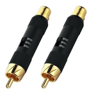

now I don't know if you noticed but I don't have the pots nor the attenuators at the input, I'm just using the volume from my OPPO player.
could that be the reason for the little buzz/noise?
You should have a 47K resistor from grid to ground on each 4P1L. If you pull the RCA cables, the grid has no ground reference and that can cause damage to the 4P1Ls.

Thank you! Btw I'm waiting on the attenuators, they are in the mail from France
