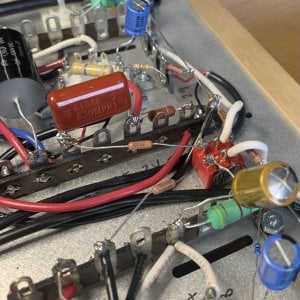

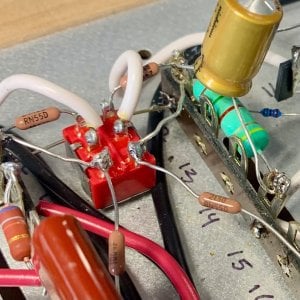

Jameson: thank you. Here are two photographs, of the DPDT Toggle area, as of March 4, 2026:

So I'd probably reach out to replacement parts to get a new cap, then I'd spend some time cleaning up 12U and the back terminals on both sides of that switch. Those switches are a little tricky because you don't want to melt them but I think they could use a little more heat.
Note that I'm trying to get better at providing tech support but that PB might have a different take or some other ways to improve the situation.
