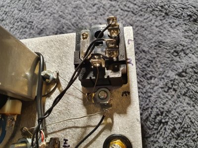

Ive got some DAC noise on my SEX with some of my headphones. And I was wondering if I need to include both ground leads connected to the ground of the inlet plug for it to have the desired effect?
NVM, theres only one going to the inlet ground..
