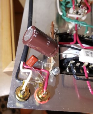

I would recommend purchasing a 0.1uF X7R capacitor (leaded, not a surface mount/smt).  Solder that between the ground shell of the red RCA jack and terminal 22.  That may or may not solve the problem, but it's a cheap experiment to try.
Assuming I got the right part: it didn't solve the noise.
Now, with the Crack sitting besides the non-airplane-mode laptop,
a) when no RCA jacks are plugged in: audible hum on both channels, increases when volume is turned up. Masks the initial left channel crackling.
b) with RCA jacks plugged in (either to a cellphone or another grounded DAC): the audible hum mentioned above is gone - but the left channel crackling remains
The good news is: just 50-60cm of distance between laptop and Crack will reduce the left-channel-crackle to almost nothing. I'll just re-arrange my setup and take the capacitator out again :-)
PS I can't seem to insert the attached image. The capacitator reading is 104KH 250VMY. It's attached to terminal 22 and the ground lug of the red RCA jack.

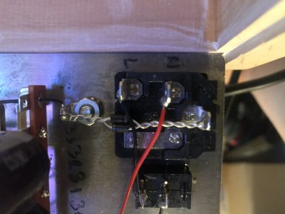

I have an Audiolab M-Dac connected to my PC via USB and prior to this, there was noise leak at 0% volume (could still hear music), an audible background noise past 75% volume and moving my mouse on the screen caused background noise as well.
Now 0% volume silences all sound, volume knob turned to 100% has no background noise, and no more background noises with my mouse.

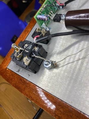

I have these noises with a new MacBook>Topping D50 III that otherwise sounds great. I'm using it in a system with a Smash preamp. Interestingly, when I replace the Smash with Akitika SS preamp or DeHavilland Ultraverve-no noise. When I use the Smash with Audioquest Dragonfly DAC noise is gone. Ill try the mod. Are there different USB grounding issues between DACs?
I did the mod on my Smash-UP. See attached photo. So far so good with sound-much better. In the Smash the distance between the ground/earth on the IEC and the chasis ground is longer and the twisted leads were barely long enough.
Basic question: In testing continuity between the IEC ground and chasis ground-no continuity. There is continuity between each lead and its attachment so I know the joints are at least conductive. Do the diodes somehow prevent continuity as tested by multimeter beep?
The diodes need about .7 V to switch on and your meter is not supplying it. Look for a specific setting for checking diodes maybe even marked with a little diode symbol.
