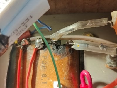

oof...that doesn't look good. they sound so good I'm a bit surprised to see burns...

Those terminals would be labeled 1F and 1S (left to right) if I am correct. That would be the finish and start of the high voltage winding; the tap 1T is opposite 1F on the opposite end of the winding. That suggests this may be arcing, though burning by a misplaced soldering iron is also a possibility. The voltages look good.
The PGP8.1 has been out of production for a long time now, and a replacement would be difficult to find. You may have to live with this for a while. I have no expertise with repair of power transformers so I hesitate to suggest more than cleaning it up gently.

Those terminals would be labeled 1F and 1S (left to right) if I am correct. That would be the finish and start of the high voltage winding; the tap 1T is opposite 1F on the opposite end of the winding. That suggests this may be arcing, though burning by a misplaced soldering iron is also a possibility. The voltages look good enough to say that it's not leaking very much now, but it does make you worry.
Hmm, yeah kind of a bummer. I suppose I could have a couple of new ones made to spec at some point. I should start looking into not that I suppose don't want to wait for issues to arise.
I'd agree with PJ that is was either a careless soldering iron, or maybe some debris that got lodged between those terminals temporarily and burned off. I would get some Q-tips and alcohol and try to clean that off gently if you can, but since the voltages are OK, it's not an enormous concern. (what is a concern is that there's carbon there trying to connect the two terminals).
ah yes, I see why that would be a concern, I'll clean it up best I can.
I'm general the wiring kinda freaks me out on these, the first one I took out was two wires soldered together behind unshrink heatshrink, barely holding on that just fell apart when I touched them. I was going to look to do everything at once in the future but I think I should be working on rewiring ASAP.
