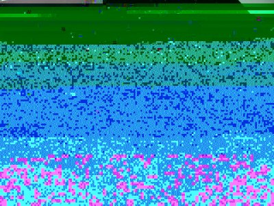

I picked up that led at a local electronics shop here, the guy had a bag full of different colour 12 volt led`s, the base mounted first and then the led slipped in threw a plastic insert from the bottom, sorry no parts #, here is a pic of the base.
