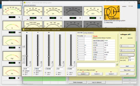

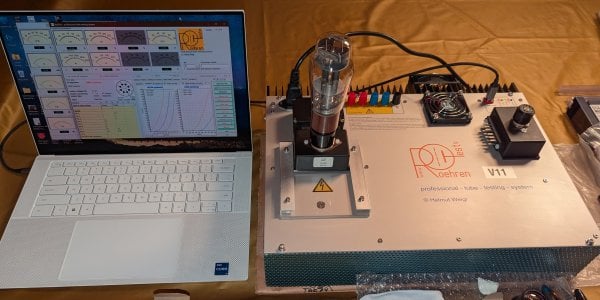

As I suspect at least some other people also have, I've amassed a collection of tubes over the decades. I'm making a committed effort to sort out a life of vacuum tubeage. This requires that I go through all the vacuum tubes I've got. To aide in this, given the sizeable scope, I built a RoeTest V11 vacuum tube testing system. It looked like a better tool to manage the production level required, rather than my vintage testers (mostly a TV-7D/U and Heathkit TT-1).

I checked each one with the RoeTest. All tested well, and test results corroborated closely enough with tests done previously with the vintage testers.
