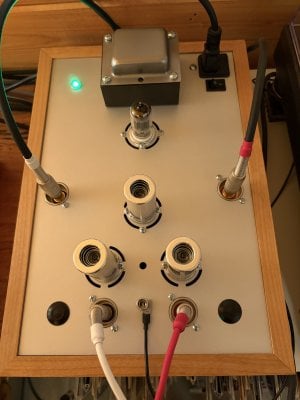

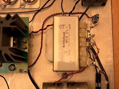

I put a spiffy green 3v panel mount LED in my nixie clock recently that I like the look of. I noticed they make them in a 6v version as well, which I figure should work pretty well on the DC heated kits.
I personally have left on both my Mainline, and Eros 2. Between the tube shields and the chromed tops of the reg tubes it's been easy for me to forget (unlike the Crack variants with bright 6080s). Any concerns with wiring in one of these 6v LEDs to the 6.3VDC heater connections? What would be the ideal place to hook them up?

I don't see any reason that these wouldn't work on AC as well.
Just be sure there's infinite resistance between both terminals on that LED and the metal housing.
Thanks PB, I'll double check that. Do you think that reg ol' unshielded wire would pick up additional noise to the audio signal and should I find some shielded twisted pair similar to the existing heater wiring? Would daisy chaining off the last 6.3v heated tube be best?
If you're putting this on a Mainline or an Eros, there isn't going to be a lot in the way of noise on the heater supply to radiate anywhere.
Did the same thing on the mainline. :cool:

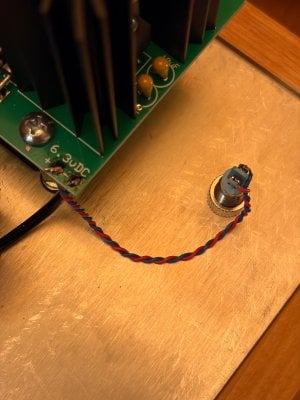

PB, so there does appear to be existing 6.3vdc lines I could similarly tap into on the BeePre... Reg+/- on the DC Filament Supply board. I know these feed the 300b's which are DHTs, but wouldn't tapping directly off the board with a short, twisted wire like I've done with the Eros 2 and Mainline be ok? Or bad idea anyways because of their sensitivity? Suppose I'm hesitant to use the AC line due to flickering etc. Thx!

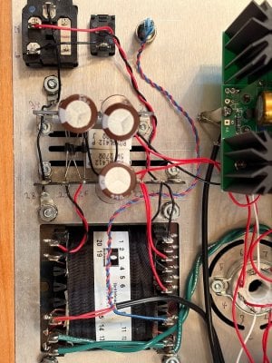

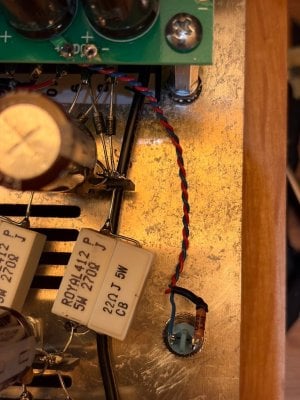

You can go off the unused "DC" pads on the front of that board, which come before the regulator. The voltage will be a little higher than 6V, but LEDs aren't typically picky about this kind of thing.
Thanks PB, that worked well! I saw the voltage there was 7.4vdc so I added a resistor I had laying around (3.24k). Bit on the dim side, but the other two are rather bright so I might add a smaller resistor to those as well. At any rate, very happy with these indicator LEDs! For me they offer peace of mind that I turned everything off when I walk away and are a pleasant addition looks-wise.

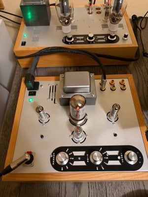

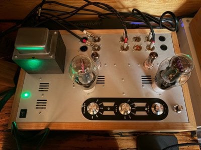

For what it’s worth, I ended up with a 470ohm on the 6.3 lines (mainline and Eros) and a 750ohm resistor on the 7.4 line (beepre). They are all of reasonable brightness and look the same.
Suppose there isn’t much point in the 6v LEDs doing this, but oh well lol.
Totally not needed with the 6080 glow, but I didn't want the Crackatwoa left out of the fun and my consistent look. :cool: No issues hooking one of these up to AC as PB suggested. I went with a 3v LED + 715ohm resistor combo this time around. The 3v ones are easier to find and if I'm adding a resistor anyways, not really any point in tracking down a 6v version.
