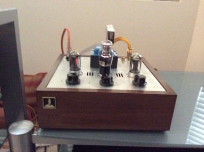

Wow...this thing is now ready to plug in and play some music. But not before the badge is installed....
The Smash was plugged in my main system in place of my old Audible Illusions preamp and turned on...and yes...we have music. Any problems you might ask? Well yes but that's for another thread.
And this concludes this build thread guys and gals. Thank you to all you've read and replied. I really appreciate your enthusiasm and help with this, my first DIY audio project.
