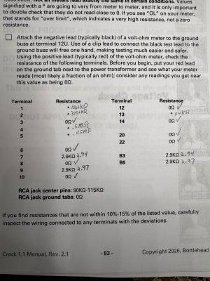

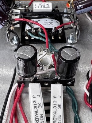

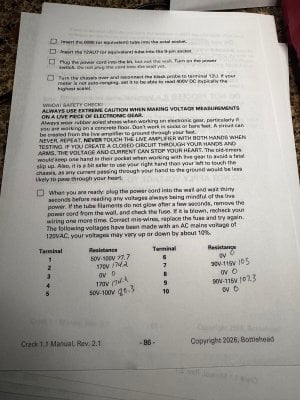

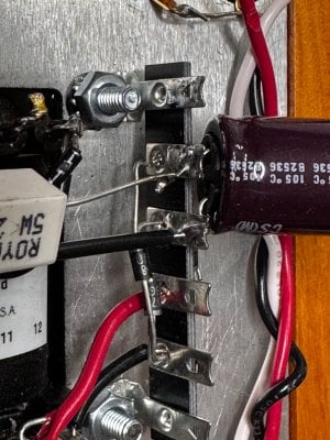

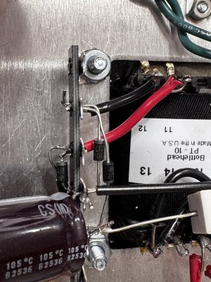

Alright I fixed the wiring back to 122V. ( I had searched for the terminals one at a time in the manual to make sure everything was wired correctly on the transformer and didn’t look at the headline above that section, thought I had it wired wrong and had actually incorrectly rewired it, hence the second blown fuse). So in reality the only item that was wired wrong on here was the cap on RCA jack side of the transformer. I’ve since fixed that and gone back down thru the wiring in manual and everything is checking in now. I checked all the caps, resistors, and rectifiers orientations and everything is looking spot on. I pulled the tubes and gave it one last resistance test. How’s this looking?You do not have the power transformer wired for 122V.
