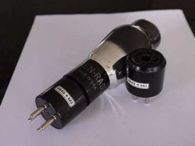

No particular favorite, usually running 300B, sometimes 6A3. I enjoy both. And a 6B4G with adapter works too.

Any idea where I can get tube socket adapters so I can run the 6b4g
I found one 4 pin to 8 pin but it doesn't list the 6b4g as one of the tubes you can use. Will it be connected properly or is it something that needs to be custom made?
Seller is caryelectronics (14973)
Item number isNumber151166600567
Can someone verify this is correct?
That would not work, the pin-outs are different. I'm weary of those sellers claiming 5Z3/80/6A3 to 5U4G/6B4G, they're just not the same. Found only one correctly listed, item no. 391676079868.
Or make your own.... ;)
Thanks so much that's exactly the help I was looking for! I don't know why that one didn't come up with my search. I did buy a pair so hopefully they will work out.
