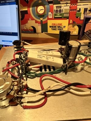

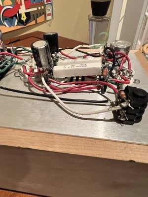

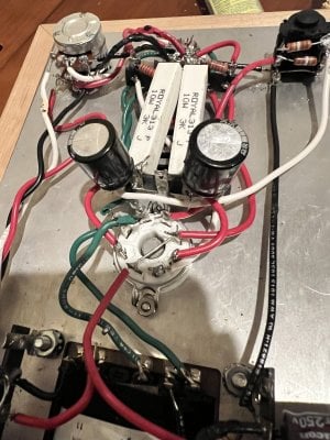

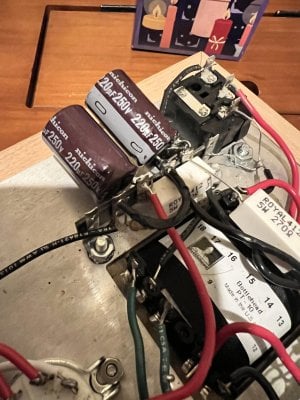

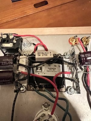

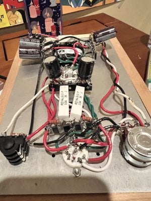

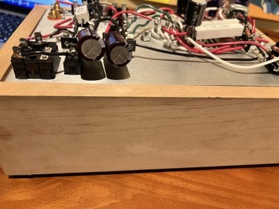

Hi everyone,
I’m having trouble with my Bottlehead Crack and could use some guidance. Here’s what happened:
  • I followed the build instructions and did a resistance check, everything looked fine.
  • When I powered on my build to do the voltage check, a loud buzzing noise came from the transformer and the fuse blew.
  • Since my soldering is messy (first build!), I suspect a wiring issue, however I cannot figure out where the problem is.
I’d greatly appreciate any advice or things to check before I risk replacing the fuse again.
Thanks in advance
IMG_5373.jpegIMG_5363.jpegIMG_5364.jpegIMG_5365.jpegIMG_5366.jpegIMG_5367.jpegIMG_5368.jpegIMG_5369.jpeg

It looks like you have a backwards UF4007 diode in your power supply.
You will get no left channel with the white wire connected to the headphone jack as it is.
Thanks so much for your help, Paul. I resolved all the issues and now it works perfectly!
