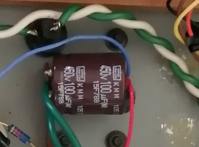

Considering the age of the am, it is possible the 100uF electrolytic filter capacitor is getting old and not functioning as it should.

I replaced the 100uF electrolytic filter capacitors but it made no difference. I've again checked all the joints, measured the voltages in L & R monoblocks but there's no significant differences that I can find. Resistors seem to be functioning at the right ohms.

We'll do what we can to help, but there is a limit to how much help we can provide, since the circuit and most of the components are changed from the original and unknown to us. The filter choke on the top side is not original, and the center tube socket is also not in the original, though it appears to be used as a terminal strip. We may need more pictures, too. Just so you know what to expect.
