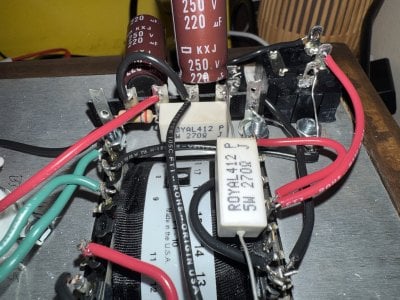

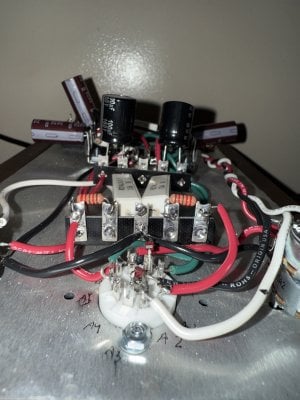

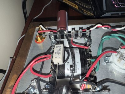

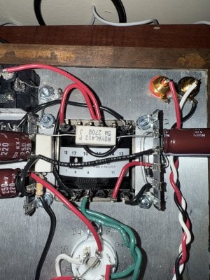

N Nugy New member Aug 23, 2025 #1 Every terminal has passed the resistance checks besides B3 which just read OL. Any help is appreciated thank you.
Paul Birkeland Moderator Staff member Aug 23, 2025 #2 Can you post some photos of your build? What resistance do you get at terminal 7?
N Nugy New member Aug 23, 2025 #3 Paul Birkeland said: Can you post some photos of your build? What resistance do you get at terminal 7? Click to expand... 0 volts
N Nugy New member Aug 23, 2025 #4 Nugy said: Every terminal has passed the resistance checks besides B3 which just read OL. Any help is appreciated thank you. Click to expand... Attachments image.jpg 2.2 MB · Views: 8 image.jpg 1.7 MB · Views: 8 image.jpg 2.6 MB · Views: 7 image.jpg 2.7 MB · Views: 5 image.jpg 1.9 MB · Views: 7
Paul Birkeland Moderator Staff member Aug 23, 2025 #5 You appear to be missing the wire that connects to B3.
N Nugy New member Aug 23, 2025 #6 Paul Birkeland said: You appear to be missing the wire that connects to B3. Click to expand... Sure am thank you
N Nugy New member Aug 23, 2025 #7 Paul Birkeland said: You appear to be missing the wire that connects to B3. Click to expand... Hey soldered that wire in place and now I’m getting readings of -0.1 volts on all points that have voltage values and no led light up
