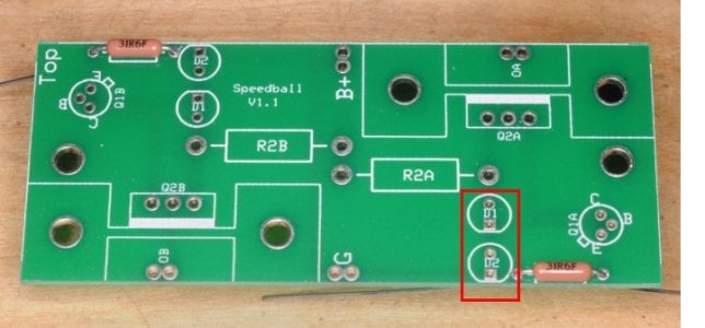

LEDs nearest Q1A do not light up.

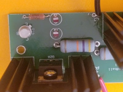

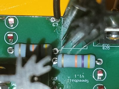

The 3K resistance that you attempt to measure with the Speedball installed will not measure 3K because you've removed the 3K resistors from the amp.

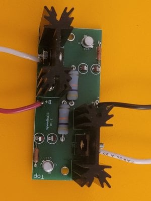

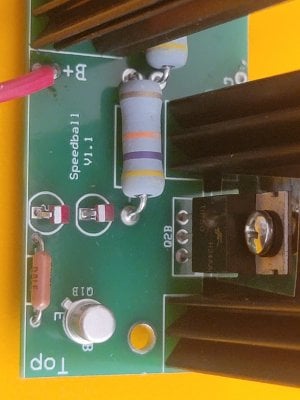

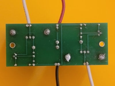

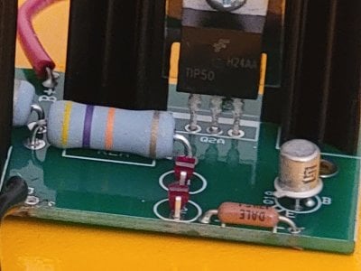

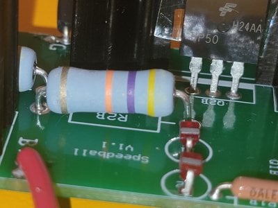

Can you post some build photos of the larger Speedball board?
My concern is that
OA measures 1.45V when it should be 75-100V
and OB measures 115V when it should be 100V max
oh yeah and that 2 LEDs dont light up :)

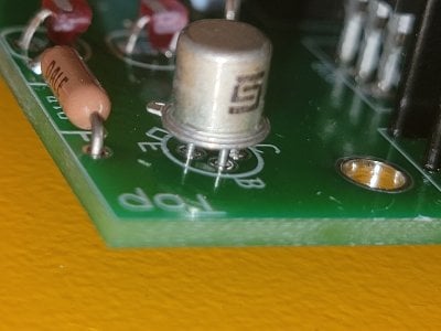

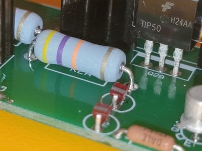

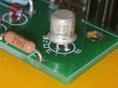

You'll want to turn the heat on your soldering iron all the way up. If you have one of those little blue Hakko stations, it's easy to think you're turning up the heat when you're actually adjusting the calibration. Also be sure you have 60/40 rosin core leaded solder.
To view this content we will need your consent to set third party cookies.
For more detailed information, see our cookies page.
I suspect with proper reheating of the solder joints on that board that it will work properly.
Yep, I needed to calibrate the iron, it was way off. I honestly didn't know that was a thing. I'll need to reheat the crack joins as well. Thanks!
