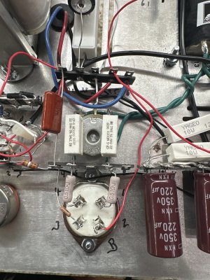

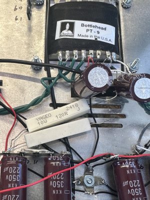

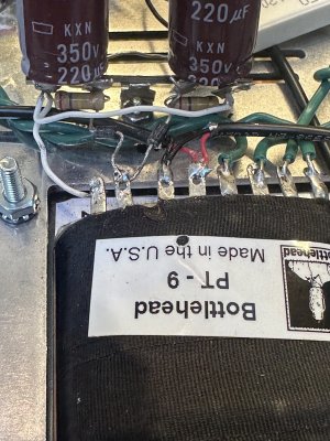

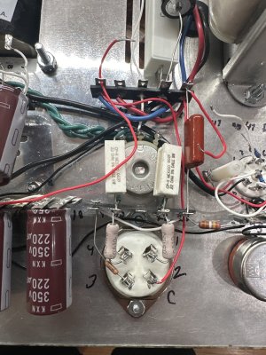

This is confusing for me as about an hour ago I was able to get 283V at 9 and 540V at 14 using a jumper. When I soldered everything together including the wire from 15 to 17 I started blowing fuses again. Reversed things again to what you see in the pictures and am blowing fuses at power up.
How about the wiring at the back of the power transformer and the IEC inlet/power switch?
A fault before the power transformer can also pop the fuse.
I’ll double check all that this evening. The fuse does not blow with the diodes disconnected. Voltages at the heater wires is about 6.6V. AC across 7 and 8 is 190V
The ground wires at the lug by the IEC were not soldered. I have soldered them but need to get some more fuses. Would 2 amp be ok?
2A would be reasonable.
You can certainly replace the UF-4007 diodes if you'd like. You'll want to put each node of the power supply back onto the power transformer one at a time to know that none of those are the issue, and taking care to not have the 300Bs in the socket while doing this just to remove another variable.
If a UF4007 is causing this problem, I would expect it to read like a piece of wire in both directions with your meter.
Nothing wrong with UF4007. Soldered 2A and no more blown fuse. 10U 269V, 14U 533V, 15U 248V
My guess is it would occasionally not blow the fuse when the alligator clip on 2A secured the connection. Thanks for getting me to look in the right direction.

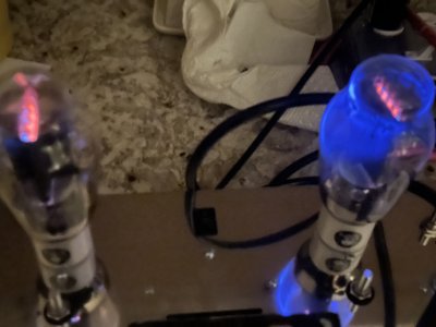

The D side tube ran very hot with a bluish glow. The photo over emphasizes the color considerably. Very hot to the touch compared to the A side tube.
Switched tubes to other side and the fuse blew on power up. Switched them back and it powered up but still very hot on the D side

Generally blue glow doesn't indicate a problem, as a really hard vacuum will tend to produce more glow. It's good to see both bias voltages around 75V. What are the voltages at pin 1 on each 300B socket?
S
Got things working with 71V an 71.1V.
