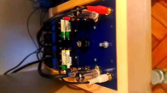

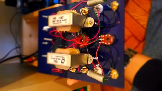

Built one myself! But with chokes.
Quickie with PJCCS is better, but as cpaul wrote CF is the way to go with high sensitivity power amps (if you don't want to pad the standard Quickie output, which is the cheapest option).
Some shots attached.
Thank you all for the super fun project!

Nice looking amp, Bonzo, and thanks for the post.  I see what looks like Hammond 156C, which looking at the specs seems like the choke of choice (including the price!).  150Hy and 3700R with 8mA.  I will definitely look into using that.  I suspect it will be better.
