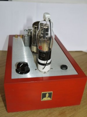

Not a 6SN7, but using the earlier 6F8G with a very high quality adapter. Works beautifully, & sounds wonderful.
I wouldn't really like to mention a competitors name on a manufacturers forum, but if you Google '6F8G adapter usa' it should lead you to it. They are made with high quality teflon sockets, gold pins, not cheap but much better than any of the ones out of China.
Can also be made to order in any configuration you want.
