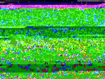

Here's the supporting structure in the attic. The threaded rods on the lower panel hold the mount to the ceiling. No way in hell Shawn would have gone in there with all those spiderwebs.

Here is the proj hanging from the winch cable. The straps are from the first attempt at raising it. Dumb idea.

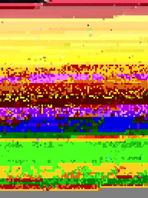

And here is the monster mounted up. Colin and I wrestled it into the cradle while Queenie pulled the last two clicks on the winch handle.
