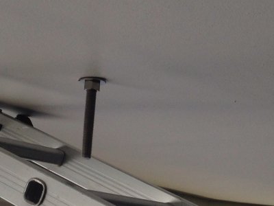

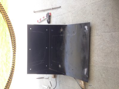

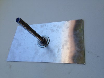

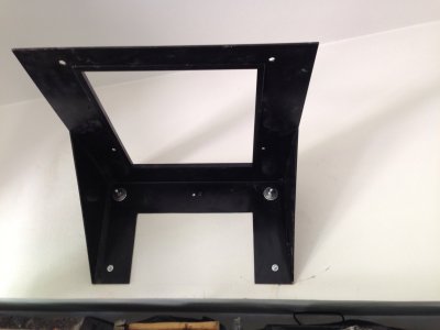

Today is projector mounting day. I had an l shaped support to attach to the back wall and to hang the projector from it. Unfortunately we went overboard and the base weighs almost as much as the projector. I was ready to abort as i was affraid the six expansion screws could not be safe enough but one of the helping guys had an awesome idea, to use threaded steel bars. The wall is a double one, bricks, space and concrete. I have some amazing stainless steel bars from a diy audio rack project. Two will support the structure. Absolutely safe. Pics and more to follow.
That looks great, beefy as heck. Are you going to hang the projector underneath the shelf or put it on top? If you put it underneath, I will make a suggestion based upon my experience in hanging my G70. Even though my measurements are "perfect" with respect to the projector and the screen being perpendicular I wish I had just a little bit more side to side and front to back adjustment. My mount had slots in it, and even with those I ran out of the last tiny little bit of twist I seem to need to get the focus perfect across the screen.

We ran out of time today. I'm very happy as it will end up being very safe which is my priority. Unfortunately not much chance to play with position.  I'll save that for whenever we build the new room. It'll hang from underneath and the holes are all set. Hope I can set it up goodly enough.

Just leave yourself a little room to play with the screen position and you should be fine. That Draper should be just the ticket.
