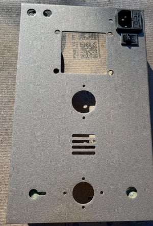

Done. I'm just going to leave it alone until weekend after next. I have a class next week that I am leading, so, will get to the build after that. Should give it about 11-12 days of cure time.
I have been baking my chassis in the oven at 160-180F for about an hour. It accelerates setting, increases gloss, and makes the paint harder. I've been using Rustoleum Hammered with that bake. The paint is still not instantly fully hard, and so I give it another week at least before building.
Thanks guys. I thought about the oven, but my wife would probably kill me. Lol. Plus, I still have the IEC connector and switch installed. No way those are coming out without breaking them. Super tight fit.
I’ll just wait a couple weeks.
FWIW I always let Rustoleum hammered finish paint sit for AT LEAST 2 weeks. Usually more. Its great paint, I use it all the time. But it takes forever to harden up fully. I thought about using the oven method but my wife would kill me. ;) So I wait patiently and sometimes place the painted parts in a sunny window.
The Crack amp is a very good design and sounds great. I picked up a kit from the first run many years ago. I'm thinking around 2010? It's still running strong on my computer desk. You'll love it.
Be careful baking hammer finish paint. If you get it too hot it can get brittle and crack over time. Scott's suggestion of around 160-180F for just an hour is a good one. Two weeks at room temperature is a good approach as well.
The oven thing isn't in the cards for me, so I just have it in my home office hanging out for a couple weeks. It's tough because I want to build it!
So, disappointed in myself for my carelessness. Not only did I slip with the wrench tightening the potentiometer, but I then DROPPED the wrench right on the chassis....
Taking everything off except the IEC connector (no freaking way that’s coming off…it was TIGHT getting it to snap in.) I'll put blue painters tape around it.
Hitting it with more paint here shortly, then have to wait a few more days to cure. To be honest, I'm not sure I let it cure long enough anyway. I would think that 6 full days in my 68 degree office would be enough, but maybe not?

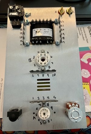

Hardware installed. My sharpie is way too fat, couldn’t label 16, I’ll figure it out.

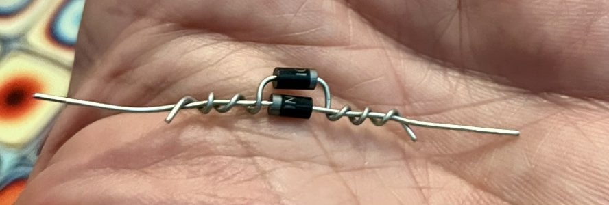

Quick question. I am installing the two diodes between the IEC ground tab and the safety ground in the chassis. I plan to use USB DAC so figured it was worth while. Is this acceptable to do it this way, and just have the one lead in each terminal? I have not soldered anything yet, but the pic shows what I mean.
Yes, you might also find that it helps to take your needle nose pliers and push those wraps up against the diode body so there's more thin lead available to slide into the holes to get those into position.
