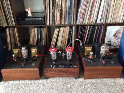

Hi Robert.  I'll say that the EML's are not perfect by any means.  My buddies 6sn7 Akido preamp has better detail and highs but can't touch the intimacy of the EML's in the BeePre.  It's a compromise as is everything in audio.  300B's are always colored is some way.  I guess the trick is to find the right color for your system ;)
I know what you're saying with gain.  In my listening chair with the BeePre wide open I measure 95dB on sweeps.  Everything I've done to lower the gain though has resulted in increased fidelity.  I usually listen at around -6 to -18dB and have enough headroom even with a tape source for my listening levels.  I wouldn't go much lower in sensitivity with speakers than my current 95dB Altec's.  I miss the dynamics and punch of 100dB horns at times.
One other reason to use them, they look great!
