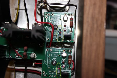

I replaced the resistors today (I didn't know how small they were  :o )
Terminal 1: 81V
Terminal 5: 84V

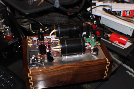

I'm very happy with the outcome
I have ordered some metal films for this mod it will be fun to try and is easily reversible the e80cc hardly gets removed anymore its defiantly on par if not slightly better than the best of my 12au7s

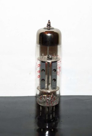

Out of interest what e80cc brands are you guys getting good results with? Using a Siemens E80CC here same plate structure and big o getter as the one below but marked only Siemens E80CC and the pins seem to be a brighter than normal silver colour. It also has a small silver V2 sticker on it?
They look like Tungsrams.
Have also tried Philips E80CC gold pin, rebranded by Mullard.  This tube is one of my top five noval driver tubes.

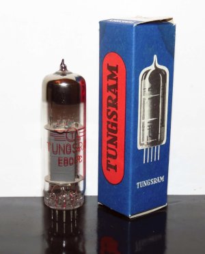

I'm currently using a Tunsgram e80cc which I found to jive amazingly with the hd650s (pictures attached)

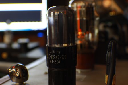

believe it or not but most of my 6SN7s have similar soundstage on Crack to E80CC Amperex..love it ,this grey skirt VT-231 sounds very good
I'm very glad I can use both

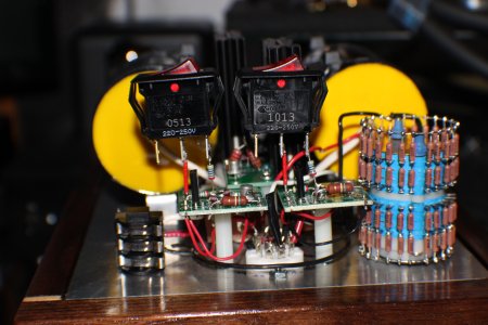

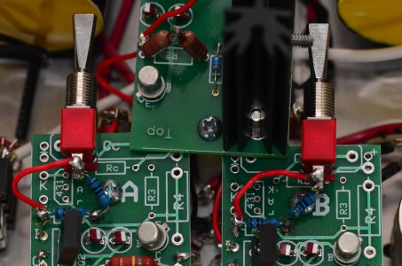

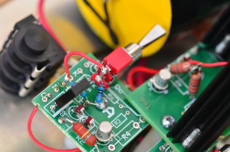

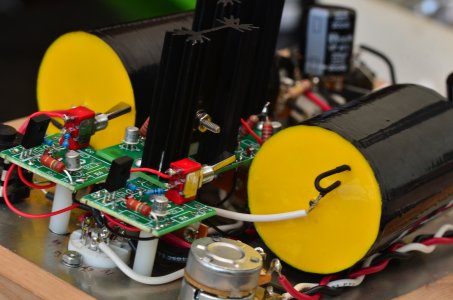

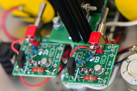

So I finally got done with the mod, voltages check out and I'm extremely pleased with the results!
I ended up replacing the two R1 resistors (237ohm) on the small speedball boards with 470ohm resistors. I then wanted a way to switch back to the original set up for 12AU7 rolling, so I wired a SPST (single-pole single throw) in series with another 470ohm resistor, which was then wired in parallel with the newly installed 470ohm resistors. When the switch is turned on the resistance through R1 drops to 235ohm and voltages check out!
Thank you bottlehead community!
edit: In terms of sonic differences, I've noticed a more controlled low end combined with an increase in detail in the mids. Current set-up is tungsol 5998 + tungsram e80cc + hd650s.

OK started looking for a pair of switches lots of choices but what voltage rating should I be looking at to keep things safe?
Voltage rating isn't important.  The switch will have less than 2V across it, and technically will never be switched when any DC voltage is present.
I still do recommend gluing them to the PC boards.
