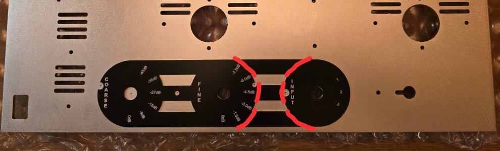

I'm assuming the best way to keep balance control with the BeeQuiet would be to wire it directly after the input selector (same as stock without upgrades). So I would just skip page 21 of the BeeQuiet manual (not wire the 100k resistor between N5L/N4L and N1L/N2L)? Any resistor changes needed other than skipping the balance control deconstruction steps?
Drilling sanity check:
Assuming that the balance pot should be directly after the input selector my thought is to keep them next to each other, and to bump the coarse/fine pots to the left. Red lines indicate where I plan to cut the acrylic to split the layout.
Layout order: Coarse Fine Balance Inupt
Any possible issues with this move other than the obvious extra holes etc.?
It does look like I'll get the coarse attenuator kinda close to those 5W wirewound resistors. Other than possible clearance issues is proximity a problem?
Thanks for looking!
The little plate the attenuators mount to will space those up a bit, so it's not the end of the world. Is there enough space to just put the balance pot to the right of the selector switch's stock location?
That does seem like a more sane approach...there IS room especially for an audio note balance pot (very small footprint, also 100k) which I've used on my crack. Guess, I'll mull over it a bit more, but I'm excited to finish the top plate and get building. Would prefer to drill any holes I want 1st.
Are my assumptions about the wiring correct?
