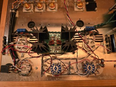

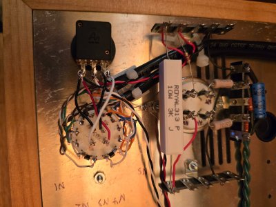

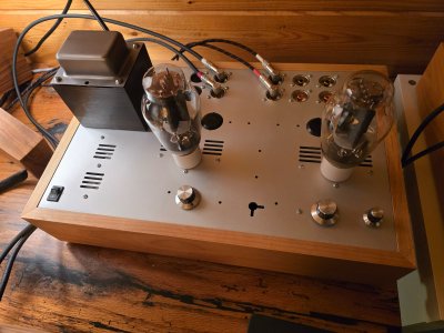

Build update y'all. 😎
Audio note balance pot installed in it's new home to the right of the input selector. All working and sounding beautiful. I sould be nicely set up to install the upgrades and retain the balance control.
In retrospect, I should have given myself some more room around the selector, but it wasn't too bad.

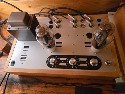

Upgrade in place!
Basic instructions in case someone is interested in the same.
BeePree:
Removed the terminal strip N.
Wired the selector switch output directly to the Balance Pot input.
Balance pot outputs to 4L/2L + 14L/12L.
Bee2Quiet:
Skip the following steps:
Cut the four wires leaving the N terminal strip and
entering the balance potentiometer at the terminal
strip.
( ) Clip the red and black twisted wires connected to
the lower level of the balance potentiometer at the
balance potentiometer. Untwist the wires two turns,
and strip ¼" (7mm).
( ) Attach the red wire to N5L. Attach the black wire to N4L.
( ) Attach one lead of a 100KΩ ⅛W resistor (1003F) to N5L.
Attach the other lead to N4L. Solder both.
( ) Clip the white and black twisted wires connected to the
upper level of the balance potentiometer at the balance
potentiometer. Untwist the wires two turns, and strip
¼" (7mm).
Attach the white wire to N1L. Attach the black wire to N2L.
Attach one lead of a 100KΩ ⅛W resistor (1003F) to N1L.
Attach the other lead to N2L. Solder both.
