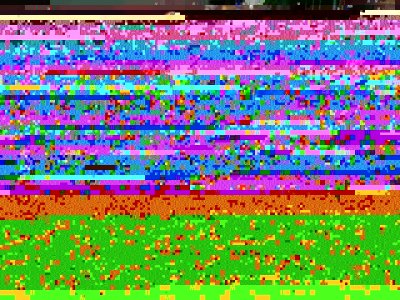

Hammond chokes in place. They fit and there's no need to modify the base.
BeeQuiet switches also in place.

One output channel wiring. A single 89259 feeds all four outputs. No piggibacking here!
I think it might sound better with four runs per channel, you should give it a shot!
(Just joking)
Grainger, not me. I haven't even tried the bh power cords yet.
Paul, look at this other pic showing the output wiring of both channels.

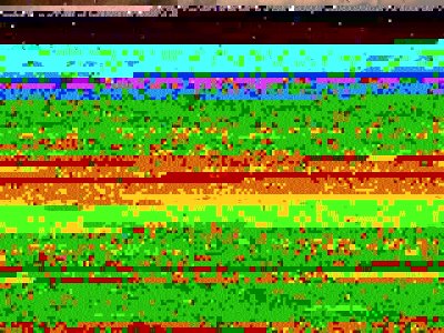

Done with the PITA input and output wiring. Next is the beeQuiet and then the actual preamp power and signal circuits. I'm getting there!

Xavier,
Jamb nuts!  I hadn't thought of that!  I have my gold RCA jacks on my equipment backing off all the time.  I need to get a set of nuts and double nut them.
By the way, beautiful, careful work there.
Grainger,
These are the Neutrik rca jacks that BH uses in the tube repro and now in the BP. They require larger holes than regular rca jacks but are now and, as you suggest, stay in place forever.
Grainger49 said:
Xavier,
You'll need to remove the jack hot wire to add a nut and then resolder. May I suggest that a couple of drops of Epoxy on the RCA jack nuts and top plate will securely keep the nuts from backing off.  Loctite and CA won't work as they can form an isolation barrier between the jack and the ground solder lug.  (Don't ask how I know this .....)
