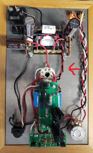

I've posted before trying to nail down an annoying hum in my Bottlehead Crack with Speedball upgrade. We've done some debugging using the chopstick and found some additional information. The hum actually occurs without a source hooked up and varies with the volume. We found that if you move the right most wire bundle towards the center (see arrow) the buzz gets worse. (The bundle from the input jacks to the pot.) Seems like it's picking up interference (maybe) from the transformer? I've attached a photo that may help. Any advice appreciated. I love the amp when it works but since it doesn't it has been a paper weight on my desk.
