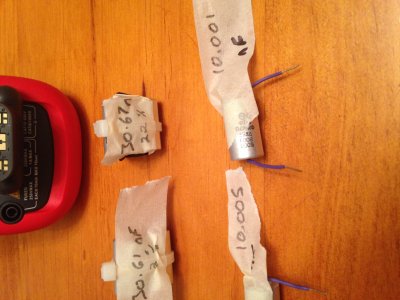

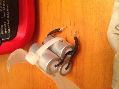

lol unwrapping didn't take long but was indeed savoured.
So out of the 10 all were 10nF or over.
3 roughly under 0.5% tolerance
3 roughly under 1%-1.5%
2 roughly around 2% - 2.5%
I kept the two with the tightest tolerance for the single 0.01uf spots and then tried to even out the next six next best to get as close to the same value as I could.
The two that were left over measured roughly 3.5% out which I guess is not to bad given they are rated as having a +/- tolerance of 5%
Now I just have to try and fit them in tomorrow...

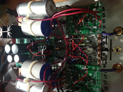

I think it is probably safe to say I’m done tinkering with my Eros for a while, it has been getting a bit of extra burn in around 100hrs now so far via my ipod to help with the Teflon caps. I also fitted four 47uf Valab capacitors (Taiwanese MKP in oils) which had been taking up space in the parts box for a while paralleling a pair up each side in place of the 100uf electrolytic on the cathode bypass.
After removing the stock RIAA caps I measured them to check against the meter readings I was getting for the Teflons and was pleased to find both gave similar results on my meter the Teflon substitutes measuring a little tighter was a bonus. I expect with a couple of dozen of the Teflons it would be possible to match and get under 1% tolerance hmm…
Taking the time to measure and fit them and the cathode bypass caps I feel was definitely worth it.

Man you really could use a larger chassis!
Do you hear any sonic change with swapping the cathode bypass caps? I'm curious as I built mine with films from the beginning.

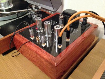

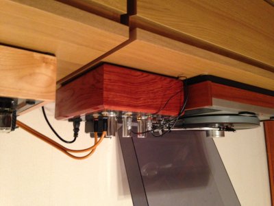

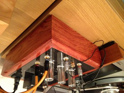

Just reached around about 150hr of burning in (feeding it tunes from a ipod) I came home today from work fired up the Sex had a shower then put a LP on, I noticed the change in presentation immediately the Teflons had starting to open up and do their thing  :D
The little ones are all asleep and I’ve got my feet up chilling out with a nice cup of tea admiring the Eros freshly transported into its newly finished Bubinga wood base spinning some Tull via the Mainline and the HD800 and it would be safe to say its simply Epic  ;D
