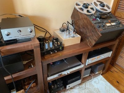

I am borrowing an old Eros Tape head preamp and am using it with a high output Nortronics head(430 mH). The gain was too low with a standard Otari head. Does it have HF adjustment pots as stock? My HF is WAY down at present and the bass seems a bit boosted. My 65 year old Marantz 7 has a HF adjustment for tape on the back panel. Sound is pretty good otherwise so far.

It is in good company with the Doshi and King/Cello preamps. I like all three of them
