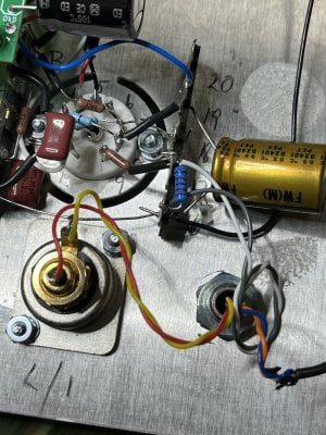

I have one side ‘done’ and would like a sanity check. To me, the wiring looks the same. What should I be seeing for resistance checks at which points? I assume I will not see my new ‘reflected’ resistance anywhere in the amp? I plugged it into a system (no signal) and the converted channel is very quiet. I can hear when I tap the SUT though, so I assume it is connected at least partially correct. For wire coloring, this is Sowter 1480. Secondaries wired in series for 1:10.
Thank you!
