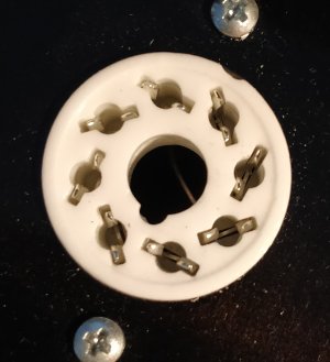

I have wiped the inside of the socket a bit and it looks clean enough to me. The pins themselves also feel pretty tight, and I'm not sure how I would go about messing with them to make a better contact.
Socket looks clean. As it is new it should be. You could try and bend the contacts in a fraction with a tiny screwdriver. Cleaning the pins by pushing the through a sheet of Scotchbrite soaked in DeOxit worth doing. Wiser heads might be able to say why the unit actually switches off and which pin might be the cause. If it is safe to do so, have a poke around with the chop stick when it is this "off" state.
