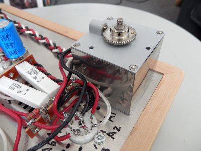

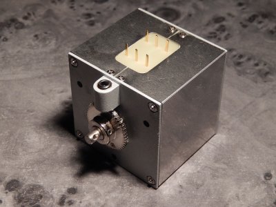

After having finished my Crack (a thread about that is stil to come)  I decided to upgrade the standard pot with a 41 stepped series attenuator.
I stumbled on the "41 stepper" after Googling for a stepped attenuator and was initially going for a 23 stepped one.
However the "41" caught my attention  :)
Also more steps would give me a better control.
This attenuator is made by (or made for) Acoustic Dimension in The Netherlands.
It comes in a few variations:
http://www.acoustic-dimension.com/attenuators/attenuators-main.htm

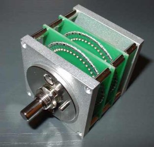

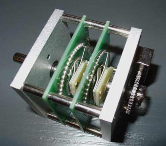

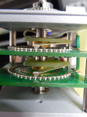

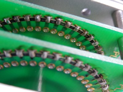

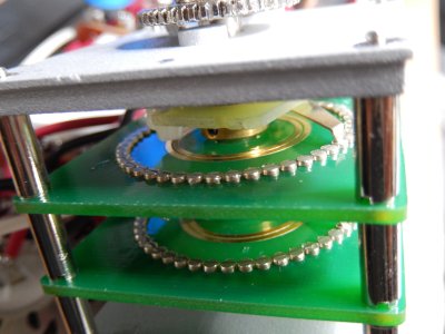

As shown on the pictures below you can see that the resistance is achieved by using 2x41 SMD resistors.
Peter the owner of Acoustic Dimension is a pleasure doing business with.

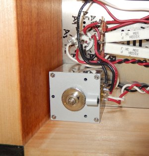

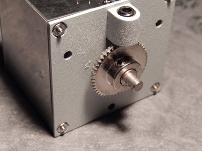

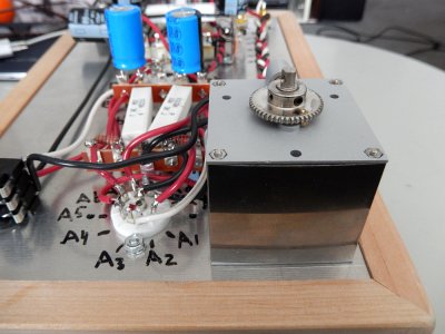

At first I was afraid it might not fit but after making the original hole slightly bigger it fitted (very tight fit.....see pictures).
The attenuator works like a charm and sounds great.
I measured both the original pot and the 41 stepped one......the original had a 1% inbalance between channels, the 41 stepper none.
Now I only hope that the Speedball upgrade I ordered will still fit  ;D
Here are some pictures:

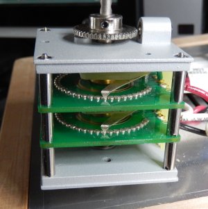

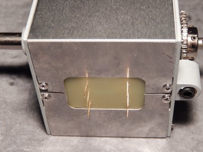

Update: Added 2 pictures (from the internet)  that show the inside, also visible the 2x41 SMD resistors.

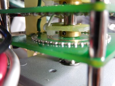

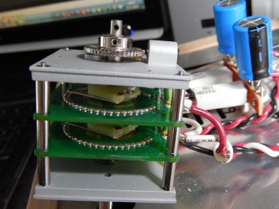

Update2: Removed the casing from the attenuator and made some photo's to show the inside and working.

Arno, that's a very nice build. Have you thought about the speedball upgrade and how it might fit with the stepped attenuator? You might have to improvise.
Boris
Hi Boris,
I totally forgot that I needed to have some room for the Speedball upgrade .....however I think its possible to move one of the PCB's around a bit to make it all fit.
Its been 4 weeks or so since I ordered the Speedball and so it should be on its way in a few weeks from now.
I'll report back when I've been able to install everything  :)

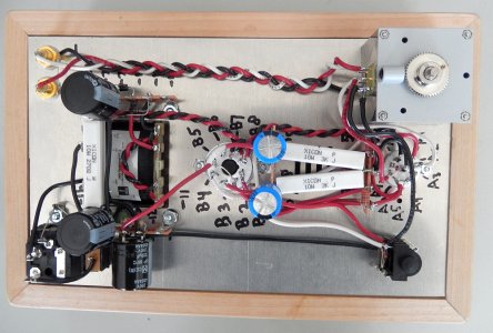

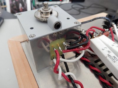

Hello,

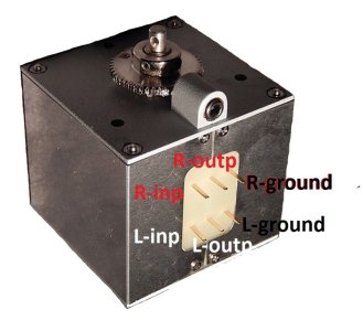

  I have the same attenuator and I'm going to connect it. Could you advise me which taps are grounds, inputs, outputs and etc .....on attenuator it's not marked :( Thanks for help.
Hi there,
Well its very simple to connect.
The connections on the standard potentiometer and the connections on the new one are the same.
So if you look at picture "Past net-6" you will get an idea how its connected.
There are 2 rows of 3 pins above eachother like this:
  Pins:  o    o    o        conections are:  R-Input    R-Output    R-ground
            o    o    o                                L-Input      L-Output    L-ground
Note: R-input and L-input means the wires coming from the RCA jacks !
So if you have the stepped attenuator placed the way I did then connections are the same as described in the Crack manual.
Let me know if my explanation was helpful (explaning in writing is harder than I thought  :)  ).
Edit: Updated with picture showing connections.
