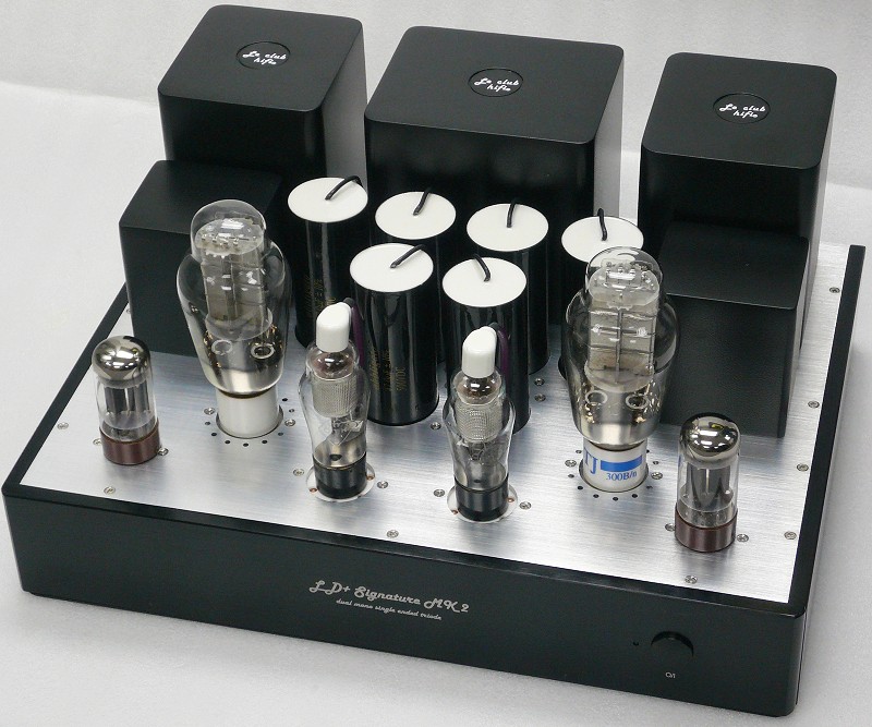

Haha, awesome. You might be able to try mounting them to the top of the chassis like this:
Just make sure to use rubber grommets where you drill the chassis so you don't inadvertently short the leads to ground.
...or just do what I do and mount them on standoffs and the chassis on long spikes ;)
