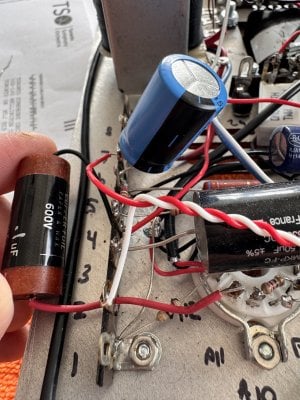

M Mark New member Saturday at 12:47 AM #1 I have a pair of copper foil caps than I want to swap in (new ones are .1uf 600v). Would the non- banded end be attached to A11 and B11 (ie to the tube socket)? Last edited: Saturday at 1:19 AM
P Paul Joppa Moderator Saturday at 9:31 AM #2 The outer foil goes to the driver plate (socket pin 11), inner foil to the power section grid (socket pin 3).
M Mark New member Saturday at 10:26 AM #3 Paul Joppa said: The outer foil goes to the driver plate (socket pin 11), inner foil to the power section grid (socket pin 3). Click to expand... Attachments IMG_5053.jpeg 1.8 MB · Views: 13
M Mark New member Sunday at 5:34 PM #4 Thank you - just to double check inner foil lead (black in above pic) still goes to L4, right?
Paul Birkeland Moderator Staff member Sunday at 8:09 PM #5 For what it's worth, in an application like this, you can install it in either orientation.
