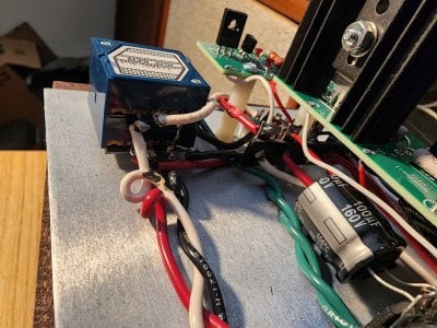

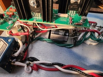

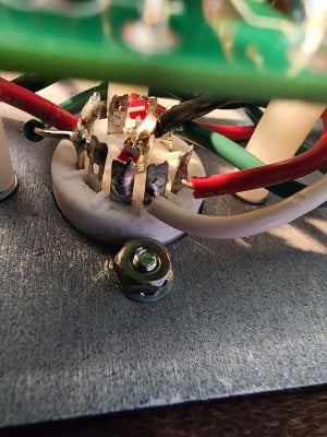

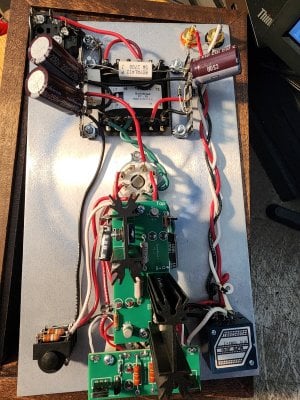

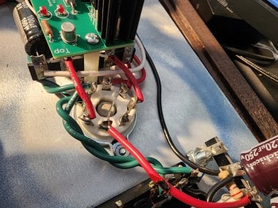

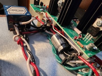

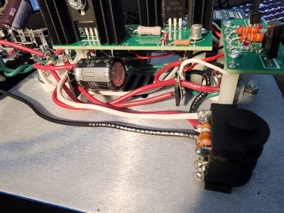

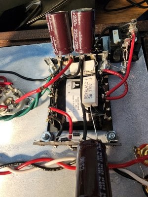

Here are some build pictures.

I'd be sure you have good electrical continuity to the chassis plate.
The Alps pot you have installed is meant to be mounted to a PC board. You can buy a bunch of different ones on eBay. Typically if you run wires to those pins, the pins will tend to snap off.
Thank you for the advice on the blue pot pcb. I ordered a couple off ebay and will install when they come in.
I think that there is good continuity with the chassis plate, but ill double check. I'll try to sand the chassis under that bolt to make sure there is good contact for good measure.

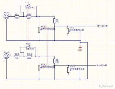

You'd add RV-R, which would be a 100K dual linear stereo pot, and RR. The value of RR can be scaled to change how the balance pot operates. You do not need R1/R16/S1. The decks of each level of the balance pot need to be wired the opposite way to get the appropriate effect.
I went back and tightened down the grounding bolt as much as I could and it fixed the hum issue almost entirely. It is still there at about 90% and above, but I doubt I could ever push this trhing that high seeing as I hover around 30%-60 for most sources. Thank you for the guidance there.
