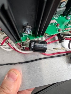

I know so many people feel the Speedball has been a great improvement in sound and so I'm wondering if I have a problem somewhere. I've triple checked all my voltages and connections, everything seems in spec with the manual. I'm including my voltages here. I'm trying to determine what else I can check. I wonder if I have a problem with one of my capacitors or transistors? Or is it possible I have somehow slightly damaged one of my tubes while putting together the Speedball? Would a problem in one of these areas show up in my voltages, or do I need to somehow check my capacitors, transistors and tubes independently? That's all I can think of to check, that hasn't already been tested and checked many times. Also, one of my capacitors looks a little melted for some reason, not sure why. AI tells me this capacitor is a problem, when I feed it the attached picture below.
