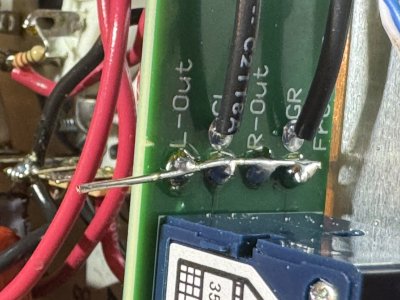

It's also possible that your main C4S board is working properly, but that there's a soldering issue related to the balance pot and the input/output wiring there, and the 6V6 grids are losing their ground reference and this is causing extremely screwy DC voltages.  I would evaluate this by temporarily soldering one bare wire across the L-Out, R-Out, and ground lugs next to the balance pot.  That will provide a DC short to ground, and if your voltages move dramatically, then you know the issues is in the input/balance pot wiring.
I won't be able to provide any more assistance on this until you complete this test.
Temporarily soldering one bare wire across the L-Out, R-Out, and ground lugs next to the balance pot.
You are going to have to tell me what isn't clear about this instruction.
Voltages after soldering bare wire across L-In, L-Out and ground lugs next to balance pot:

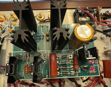

I wanted to mention that it appears that 2 of the LED's light but two do not. Photo attached
When I completed the initial build these LED's did not illuminate but I read in the manual that some illuminate and some are dimmer, so since the voltage checks were within parameters when I completed the upgrade, I never thought much of it. Can you provide further troubleshooting advise?

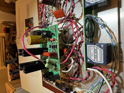

Image attached (Please note that I used leftover wire from original Moreplay build so what’s going to Plate B eyelet was supposed to be white but I used red because I didn’t have enough white wire to make that connection)
