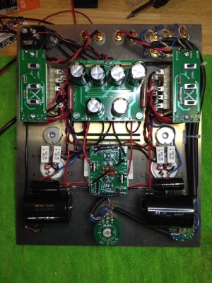

Another picture of the completed amplifier.
Boris

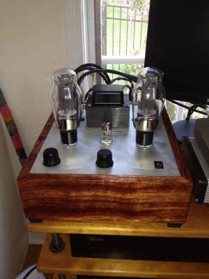

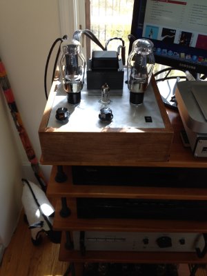

It's alive!
Couldn't wait to finish the base and will have to return to it this week. But music is playing and it sounds wonderful (Paul Simon - Graceland). The selector switch and attenuator, everything is working fine. What a great adventure!
Thanks everybody!
Boris

Not bad for someone who never soldered before.  ;)  But seriously, you did an excellent job. I'm very impressed with your first kit success.
Congratulations! Not an easy "first timer" build! If you like it now, just wait until it has a hundred, or so, hours of burn in!!!

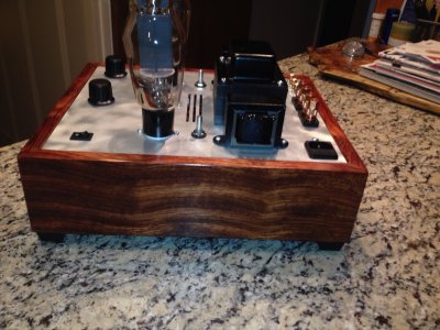

A brief update. The amplifier continues to sound wonderful. However, I was never happy with my poor finish of the wooden base. Then, I happened to see a very nice plank of bubinga wood on ebay. So, to make it short, with the help of a friend, I made a new base. All it needed is some linseed oil and lacquer finish. Now, I am happy with the whole package.
Boris

That is a beautiful piece of wood and a nice tidy build.
I didn't know you could put lacquer on top of linseed oil.  You can spray it on top of oil?  I thought it wouldn't take.
You learn something every day.
Beautiful work on the base Boris.

Grainger, there was a very nice video on finishing bubinga on youtube and this is what they recommended. It is boiled linseed oil and you have to wait a day for it to dry and then use lacquer spray.
Kris, I didn't put anything on the aluminum plate and just left it as is.
